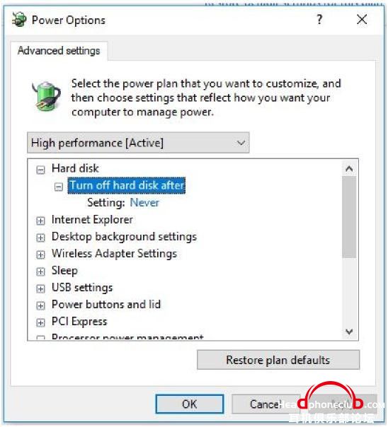

 楼主| 发表于 2018-8-8 15:51:26 | 显示全部楼层
Power Options
1. In Control Panel, click Power Options
        2.        In Preferred Plans, select High Performance .
a. Click on “Change plan settings”
i.        Set “Turn off the display” and “Put the computer to sleep” to Never .
        3.        Click on “ Change advanced power settings ”
4. In the Power Options - Advanced Settings window:
a.        Click on the Hard Drive box to reveal settings,then set “Turn off Hard Drive after” to Never .
b.        Click on the USB settings box to reveal it
i.        Click on “ USB Selective suspend setting“ double-click on Enabled and select Disabled
c.        Click on the “ Processor power management ” box to reveal it
i.        Click on “ Minimum processor state ” and type 100 in the text box
5. At the bottom of the window click “ Apply “ and “ OK ”
电源选项
1、在“控制面板”中,单击“电源选项”
2、在首选计划中,选择高性能。
            a、点击“更改计划设置”
                  i、设置“关掉显示器”和“让电脑睡觉”为“ 从不”。
3、点击“更改高级电源设置”
4、在电源选项-高级设置窗口:
a、点击:“硬盘”显示设置,然后 “再此时间后关闭硬盘” 设置为“从不”
            b、 点击“USB设置”框来显示它
                 i、点击“USB选择性暂停设置”双击 “启用”并选择 “禁用”
            c、点击“处理器电源管理”框来显示它
                 i、单击“最小处理器状态”并且在文本框中输入“100”
5、在窗口底部点击“应用”和“确定”
