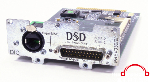

是接PC/MAC的么?有兴趣,但渣英文看不懂
The 8C-DSD DSD I/O Module type PREV039/9/1 provides eight channels of ‘Direct Stream Digital’ input and output for the ADA-8XR. The DSD interface format carries an over-sampled one-bit representation of the audio signal as delivered on Super Audio CDs (SACDs).
The DSD I/O Module can transact the DSD data in either SDIF 2 (sometimes known as DSD RAW) or SDIF 3 formats, using coaxial cables via a breakout squid, and optionally in the MAC DSD / SuperMAC format using a CAT5E cable.
When combined with the ADA-8XR’s Analogue Line Input and Output modules, the DSD I/O Module provides eight channels of analogue-to-DSD and DSD-to-analogue conversion. The Module also allows for PCM to DSD and DSD to PCM conversion where a PCM-type I/O Module is fitted, such as an AES3 I/O Module. In this case, PCM synchronous sample rate conversion can also be performed between the PCM input and output for all eight channels.
When used in conjunction with a dedicated workstation I/O Module, such as a Pro Tools HD I/O Module, the DSD I/O Module allows DSD audio sources and destinations to be connected to the workstation directly.
Whilst the DSD format uses a fixed sample rate of 2.8224MHz the ADA-8XR’s DSD I/O Module allows the user to run DSD-connected Paths with any of the ADA-8XR's sample rate and sync options
DSD卡
DSD卡

发表于 2016-3-30 18:40:24 | 显示全部楼层
1、他接受dsd进去也是转pcm
2、只认sdif3信号,能输出这玩意儿的只有ad2、tascam da3000之类屈指可数的设备

发表于 2016-3-30 18:42:14 | 显示全部楼层
另外dsd卡已停产

发表于 2016-3-30 20:56:58 | 显示全部楼层
amex 发表于 2016-3-30 18:40
1、他接受dsd进去也是转pcm
2、只认sdif3信号,能输出这玩意儿的只有ad2、tascam da3000之类屈指可数的设 ...
并不能接受AD2的输出信号,AD2的SDIF只传输PCM,AD2的说明书上有DSD的升级选项,打电话去原厂问过,因为后来出了8XR的DSD卡,所以AD2的DSD升级选项就直接太监了
DSD卡接收信号也是转成PCM播放,然而DSD的特征还是非常明显的

发表于 2016-3-30 21:42:07 | 显示全部楼层
yeziwong 发表于 2016-3-30 20:56
并不能接受AD2的输出信号,AD2的SDIF只传输PCM,AD2的说明书上有DSD的升级选项,打电 ...
那就没多少选择了

 楼主| 发表于 2016-4-2 07:44:29 | 显示全部楼层
多谢楼上两位仁兄的指教,看来要接有SDIF-3输出的播放器或界面

你看懂啊,人家是想用江门界面输出sdif到8xr的dsd卡听dsd
我的意思是,你不如就用软件转了pcm直接用火线卡听得了

问了江门界面的主人,8xr的dsd卡25针SDIF和江门界面SDIF之间连接有些麻烦
8XR的DSD卡还真不容易搞定

dsd卡有bnc辫子,输出是16根bnc,8通道输入,8通道输出
