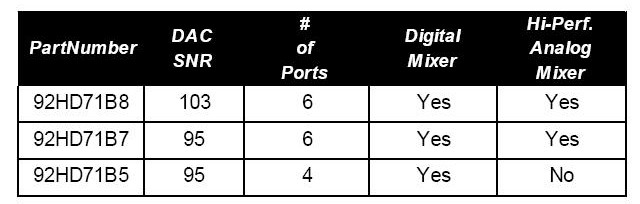

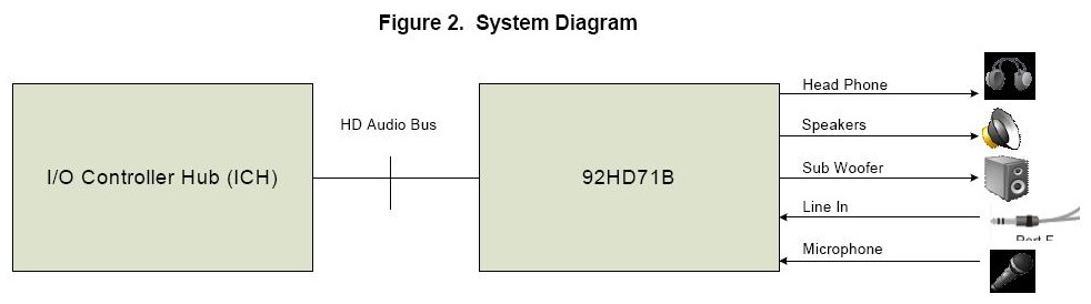

未入门,很用心!本本带spdif输出,DX们帮看看 《续》图片:
hp笔记本的声卡,本本7月份上市的。声卡数据找了N久!这是声卡厂家IDT发布的说明内容:
rt未入门,不太懂,麻烦DX们帮我看看,这声卡啥情况,水平如何,能相当于什么档次的usb外卡,直
接上耳放还是上USB外声卡、DAC+耳放、耳放......?
《《《《预算2000左右,不包括耳机》》》
The 92HD71B7 provides stereo 24- bit, full duplex resolution supporting sample rates up to 192kHz
by the DAC and ADC. The 92HD71B7 SPDIF outputs support sample rates of 192kHz, 96kHz,
88.2kHz, 48kHz, and 44.1kHz. Additional sample rates are supported by the driver software.

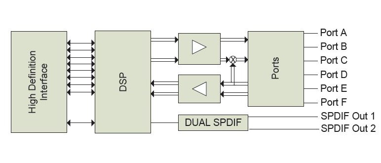

1.4.5. SPDIF Output
All SPDIF Outputs can operate at 44.1kHz, 48kHz, 88.2kHz, 96kHz and 192KHz as defined in the
Intel High Definition Audio Specification with resolutions up to 24 bits. This insures compatibility with
all consumer audio gear and allows for convenient integration into home theater systems and media
center PCs.
A second independant SPDIF Output is provided as an option for WLP compliant HDMI and SPDIF
outputs. Its function is identical to the primary SPDIF output.

发表于 2008-9-3 10:05:30 | 显示全部楼层
那么它是没有数字输出的了. 直插耳机吧.
