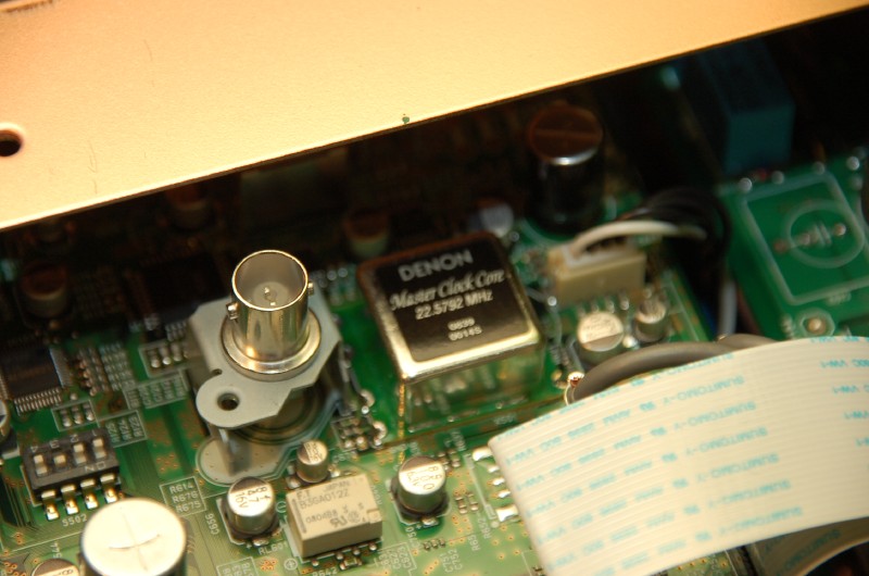

no AES out? can work as a DA?
what is that for? external clock in?
[ 本帖最后由 yangmetal 于 2009-4-17 10:45 编辑 ]

原帖由 yangmetal 于 2009-4-17 17:41 发表
这是盖子里面的东东吧...
