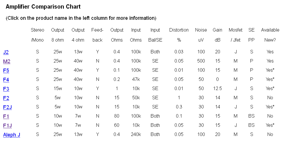

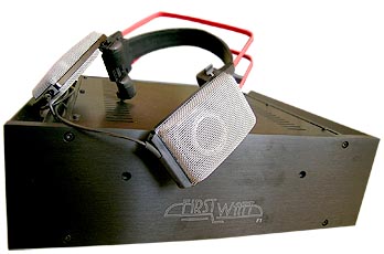

记得HEAD-FI那边有推荐FIRST WATT的后级,比如F1之类的推KK的,评级不错。国内也有烧友把玩。但不知道驱动效果如何。
有无高手测试过?

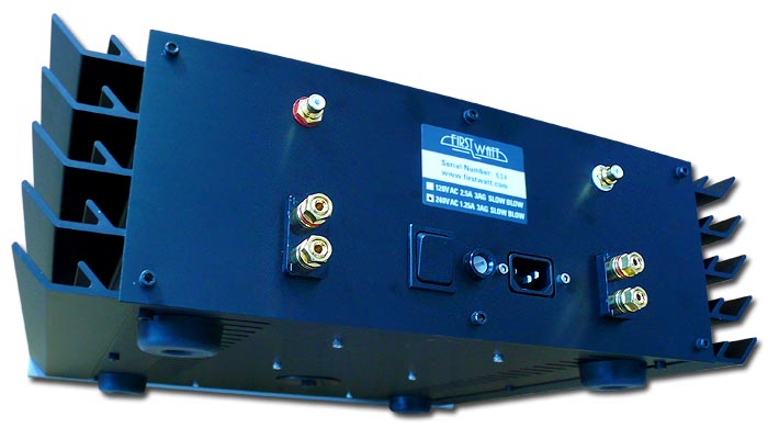

The F1 is a 10 watt per channel stereo amplifier operating in balanced  single-ended Class A without feedback.    Each channel has only one gain stage and draws a constant 100 watts.  It is a power trans-conductance amplifier (or power current source,if you like), replicating an input voltage into an output current.   A regular amplifier sends output voltage to the loudspeaker. This is not that kind of amplifier.
  This amplifier ignores the elements in series with the load circuit,  including back-emf, wire resistance, inductance and such, and creates voice coil acceleration in direct proportion to the input signal.
It is well suited to sensitive full-range drivers such as Lowther or Fostex, and allows easy use of parallel loading networks to tailor the driver response.
  It has both balanced and single-ended inputs. The input impedance is nominally 80 Kohm, and the output impedance is 80 ohms. The output noise is around 100 picowatts (100 trillionths of a watt).
The simplified schematic of the F1 looks like this:
At  this time, F1's are only available used, but there are a very few  copies of new F1's which are updated using the new power Jfets as found in the J2 amplifier. See the F1J product page.
  Download  F1 Manual and the F1 Service Manual

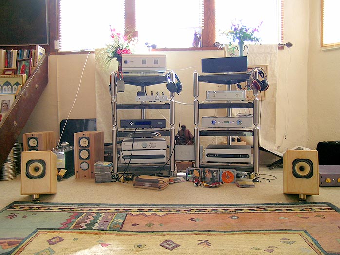

Reviewer: Srajan Ebaen
                                                        Source components: Accustic Arts Drive 1; Zanden Audio Model 5000 MkIV
                                                        Preamp: Bel Canto Design PRe2; Wyetech Labs Pearl; Eastern Electric MiniMax
                                                        Amplifier: FirstWatt F-1 [on review]; AUDIOPAX Model 88; Eastern Electric MiniMax; Butler Audio 2250 [on review]
                                                        Speakers: Cain & Cain Abby [on review]; Omega Loudspeaker Systems TS33 [on review]; Nelson Pass prototype Lowther DX-55 sealed box; [on review]; Avantgarde Acoustic Duo
                                                        Headphones: AKG K-1000 with Stefan AudioArt replacement cable
                                                        Cables: Crystal Cable Reference speaker cables and power cords; Stealth Audio Cables Indra analogue interconnects and Varidig digital interconnect
                                                        Power Delivery: BPT BP 3.5 Signature Plus; Walker Audio Velocitor; 2 x ZCable Cyclone Ref1
                                                        Resonance Isolation: Grand Prix Audio Monaco (2); GPA APEX footers underneath stands; Isoclean wall outlet; WorldPower cryo'd Hubbell outlet; Mapleshade butcher block platform underneath BPT conditioner; Walker Audio Super SST
                                                        CD Treatments: Furutech RD-2 demagnetizer; Walker Audio Vivid; Audiotop AUT 05.0
                                                        Room size: 30' w x 18 d x 10' sloped ceiling, concrete slab, 2 layer carpet; long-wall setup
                                                        Review Component Retail:: $2,500

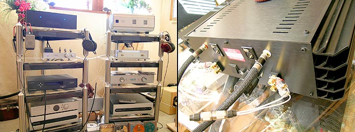

Financial Interests: click here
Source: APL HiFi NWO 3.0-GO; Ancient Audio Lektor Prime; Raysonic Audio CD-168
Preamp/Integrated: Supratek Cabernet Dual; ModWright LS-36.5 with PS 36.5; Melody I2A3; Woo Audio Model 5; Trafomatic Experience One [on loan]
Amp: 2 x Audiosector Patek SE; 2 x First Watt F4; Yamamoto A-08s; Fi 2A3 monos; Yamamoto A-09s
Speakers: Zu Audio Definition Pro; DeVore Fidelity Nines; WLM Grand Viola Monitor with Duo 12; Rethm Saadhana; Zu Presence [on loan]; Mark & Daniel Maximus & Ruby Monitors w. OmniHarmonizer
Cables: Ocellia Silver Signature loom; Crystal Cable Ultra loom; Zanden Audio proprietary I²S cable; Crystal Cable Reference power cords; double cryo'd Acrolink with Furutech UK plug between wall and transformer; Stealth Audio Indra and Meta Carbon
Stands: 2 x Grand Prix Audio Monaco Modular 4-tier
Powerline conditioning: 2 x Walker Audio Velocitor S fed from custom AudioSector 1.5KV Plitron step-down transformer with balanced power output option; Furutech RTP-6 on 240V line feed
Sundry accessories: GPA Formula Carbon/Kevlar shelf for transport; GPA Apex footers underneath stand, DAC and amp; Walker Audio Vivid CD cleaner; Walker Audio Reference HDLs; Furutech RD-2 CD demagnetizer; Nanotech Nespa Pro; Acoustic System Resonators and front wall sugar cube matrix
Room size: 16' w x 21' d x 9' h in short-wall setup with openly adjoining 15' x 35' living room; concrete floor and ceiling, concrete/brick walls
Review Component Retail: $3,000

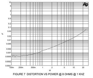

The distortion performance at 1 watt is below 0.002% and rises to a negligible 0.05% at 20 watts which would turn low-power SETs green with envy. Poster Klaus on the Pass DIYaudio.com forum suggested "would the master be offended if I called the F5 a modern FET-based Hiraga? I see some similarities, current output (open loop), current feedback, straight two-stage design (if one wants to count a diamond buffer and a CFP as one stage, resp)." to which Nelson replied: "Not at all. It's a topological classic - the devil is entirely in the details." Other posters called the circuit "an amp so simple, even a cave man could build it". "Of the Zen and FirstWatt series and for damping factor, the F5 would be the best since it has a DF of 80 and will drive 2 ohms without burping. I don't believe, however that I would point it at a speaker with both a low impedance and a low sensitivity. Reactance is not an issue. The performance is slightly more robust into a fully reactive load vs a resistive load of the same impedance. The F5 has the lowest distortion yet achieved by either a Zen or First Watt amplifier, descending to 0.001% below 1W. Suffice it to say that the F5 has more power, more damping, more current, more bandwidth, lower distortion and higher input impedance than the other Fs. Many will think it sounds better."
