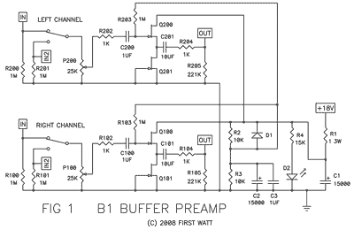

Figure 1 above shows the full schematic of the B1 bufferedpassive preamp. You can see a full-sized PDF by clicking here. There are twochannels shown with a common power supply. Supply parts in common are numberedfrom 1 to 99. Parts in the right channel are 100 to 199, and the left channelis 200 to 299. With the exception of R1, all the resistors are 0.25 watt ? Iused RN55D types, but you can use whatever you like. C1 and C2 are big electrolytictypes, with a nominal rating of 15000 uF at 25 Volts. C100, 200, 101 and 201are high quality film capacitors. You can use these values or substitute inyour favorites. For C1 and C2 I used Digikey P6890-ND. The value is notcritical, and you can use as low as 1,000 uF at 25V. C3, C100 AND C200 are 1uFmetallized polypropylene film capacitors (Digikey BC2076-ND) C101 and C201are 10 uF polyester film capacitors (I used Axon 10 uFmetallized polypropylenefrom Orca Design). Feel free to use any comparable types.
D1 is a generic 1N914 type diode, and D2 is a generic LED forindicating power the board. All of the transistors are N channel JFETs. Thestock parts are 2SK170's, LSK170's or 2SK370's, and you can use substituteshaving Idss between than 5 and 10 milli-Amps and transconductance numbers from5 to 30 milli-Siemens. The potentiometers are linear taper at 25 Kohm, butagain you can easily use higher or lower values as you like. The buffer uses anexternal power supply from 18 to 24 Volts DC. You can power it with batteries,but most convenient is an external regulated supply running off the wall. Thepreamp typically draws fewer that 0.02 Amps, so current is not much of anissue. A regulated supply is better, but the circuit is pretty good at ignoringnoise on the supply and minor fluctuations. The design uses RCA input andoutput connectors, and a DPDT switch for selecting one of two inputs. You are,of course, free to use a switch with many more inputs.
For a fact this circuit can be easily constructed withperf-board and point-to-point wiring. I know, however, that many people won'tstart a project like this without a circuit board. The Gerber artwork is postedat www.passdiy.com and I have arranged to have finished PC boards available atcost around the time you read this.
Side C
Let's talk about what some of these parts do. Theinput switch selects one of the two input signals, routing it to the top(clockwise position) of potentiometers P100 or P200. A divided input signalappears on the wiper. This signal goes to the Gates of Q100 and Q200 through aresistor R102, R202 and capacitor C100, C200. As a practical matter, the inputimpedance of this preamp is determined by this volume control potentiometer. A25 K Ohm pot gives 25 K Ohm input impedance.
R102 and R202 are there to prevent parasiticoscillation with the very wide bandwidth JFETs. C100 and C200 are there becausethe Gate of the JFETs needs to be set at half the DC voltage of the powersupply - a voltage delivered to the buffer inputs by R2, R3, and C2 throughR103 or R203.
D1 performs the service of drawing down this DCvoltage with the power supply when the power is turned off, otherwise C2 mayhold a charge for a long enough time to give you a turn-on thump when poweredback on. By the way, the time constant of R2, R3, and C2 are long enough thatit takes a minute or two for the circuit to reach normal operating values, sodon't get excited if there's no sound for a few seconds when you turn it on.
R1 and C1 filter noise coming from the externalsupply.
Q100 and Q200 are JFETs operated as followertransistors. The Source pins of these transistors follow the voltage at theGates. The input impedance of the Gate is exceedingly high - many millions ofohms, and the output impedance at the Source pin is about 50 ohms.
Q101 and Q201 are constant current sources formed bysimply attaching the Gate pins of the JFETs to the Drain pins. They providewithout loading them down or creating significant distortion.
The best performance generally comes from matching theIdss of Q100 and Q101, and also Q200 and Q201. The Idss is simply the currentthat flows through the JFET when the Gate and Source are grounded and +10 voltsor so is applied to the Drain. Often when you buy JFETs you can get them inIdss grades. I use GR or BL grades for this project.
The Source DC voltage of the JFETs Q100 and Q200 isabout the same as the Gate DC voltage (1/2 the supply voltage), and the outputfrom the Source needs to have the DC voltage removed by C101 or C201, leavingthe AC output signal, which passes through another safety resistor R104 orR204.
Resistors R100, R200, R105, R205 are there to preventthe various potential thumps from switching inputs and turn-on transients.

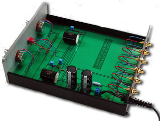

First Watt's latest DIY offering, the B1 buffer stage,is described by Nelson Pass as "a no-feedback JFET buffer that offersultra low distortion and noise with ultra wide bandwidth." If you areunfamiliar with First Watt's product spectrum and with the underlyingphilosophy of its progenitor, Nelson Pass, I strongly suggest that you visitthe First Watt website for an orientation. In a nutshell, Nelson believes thatsimple elegant designs are the most worthy of his time and your money.
The speed limit metaphor refers to the fact that thebuffer has no voltage gain and thus the system's overall gain is limited to thegain of the front-end source component plus that of the power amp. Well, thatbrings up the question of just how much gain is needed? Obviously, a CD playerwith a nominal 2V line signal presents no problems at all for the bufferpreamp. Most power amps feature an input sensitivity between 1 and 2 V, whichmean that a typical CD player needs no additional gain in order to redline mostpower amps. But take a look at the line inputs on most line stages andpreamplifiers. The signal is forced to undergo 12 to 18 dB or more ofamplification. That's very likely a throwback to the days when line inputs werenominally 0.2 V (tuners and tape decks, for example), which require a gain of1.5/0.2 (assuming a power amp sensitivity of 1.5 V) or a factor of 7.5. Now,that's about 18 dB of gain. I am certain that no CD player, whatever itspedigree, would sound its best when fed into a high-gain line-level input.Imagine the sonic indignity of first throwing away most of the signal at thevolume control and then forcing it through an active gain stage to build it upagain ? hardly an optimal situation.
Things may be less clear with respect to a phono frontend, so let's take a look at my current setup. My Grado Reference MM cartridgeis specified at 5 mV nominal output. Again, resorting to a hypothetical poweramp with a sensitivity of 1.5 V means that the phono stage requires a gain of1,500/5 or 300 to drive the amp off the cliff. That's equivalent to a gain ofabout 50 dB, not a problem for my Air Tight ATE-2 phono stage or most any otherphono stage. Again, no gain boost is needed from a line stage. All of thisshould lead to the realization that the ideal line stage may well be a bufferstage with provisions for input selection and volume control. Nelson asks thefollowing rhetorical question: "Do I feel like the pedal's to the metaland I'm only doing 55?" He speaks for me as well when he responds with"No, I'm listening as loud as I want and I sleep soundly at night, knowingthat I'm not throwing away signal with my volume control."
A Few Technical Details
First Watt Model B1 Buffer PreamplifierThe so-called"passive preamp," an attempt to achieve the ideal line stage withouta buffer stage, has in my experience been a sonic failure. Lifeless andcomatose are two descriptors that immediately come to mind. Simply inserting avolume control between the source component and power amp ignores two importantinterface issues. First, there's the issue of impedance matching. Ideally,input impedance should be high and output impedance should be low. That'sdifficult to achieve without the use of an active buffer or at least atransformer. My sample of the B1 was built by Nelson - as shown in theconstruction article schematic. The input impedance is a function of thesetting of the 25 kOhm potentiometers and ranges up to a maximum of 25 kOhm.Nelson admits that the pots on the B1 are perfectly ordinary, but that theyappear to benefit from the very high impedance of the active circuit. And whilehe has not perceived any sonic issues with them, he points out that you areperfectly free to use your favorite volume control in this application. I wouldhave preferred, for example, a 50 kOhm pot, or even better for my birthday, amotorized remote-controlled attenuator. If you're into stepped attenuators,note that his favorite for a long time has been the Elna with type RN55Dresistors. The actual output impedance is dominated by a 1 kOhm resistor (R104and R204 in the schematic). That's fairly low, but Nelson says that this valuecan be arbitrarily lowered down to say 200 Ohm, though he cautions that couldcause problems with wideband equipment. The second interface issue has to dowith the ability of a stage to drive long and/or reactive interconnects. Andthat's an area that an active buffer stage excels in, though I can't say that Ispecifically challenged the B1 in this respect, having simply dropped it in tothe an existing system which uses fairly short FMS Nexus interconnects.
Despite the Spartan appearance of my B1, it actuallyoffers a capability lacking in much more expensive high-end preamp designs;namely, channel balance control. The dual volume controls allow for independenttweaking of each channel and to my mind this approach represents the preferredmethod of implementing a balance control. It's surprising that so few modernpreamps bother with such a control. In fact, the great J. Gordon Holt onceopined that lack of a balance control is nothing short of a fatal design flaw.I find it extremely useful in compensating for inter-channel gain differencesand for loudspeaker sensitivity deviations. For example, rarely are loudspeakerdrivers matched to better than 1 to 2 dB, and with the B1, a simple tweak ofeither the left or right pot can re-center the soundstage.

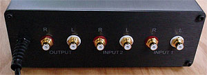

My unit was outfitted with an Ault +18V (70W) ModelMW116 switching power supply specified for medical applications. No complaintsso far, but I'm very curious to substitute a linear DC power supply such as theB+K 1671A in the near future.

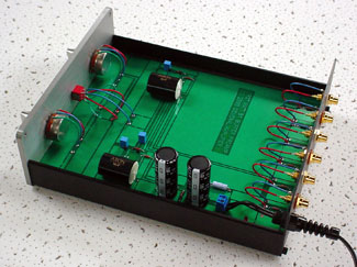

可能太久沒有製作新機器,我花了很多時間才把心情沉澱,並把相關的零件和機箱準備好。結果拖到了年底,這才一切就緒,於是趁著新年假期把第一版試作機裝了起來。
製作筆記:
1. B1 Buffer 每聲道要兩顆 2SK170-BL,而且要配對,Pass 更強調這是好聲的關鍵所在。我手邊剛好有將近 20 顆 2SK170-BL,用洞洞板搭了一個簡單的線路,2SK170 的 source 和 gate 接地,以 9V 電池,透過 1k 電阻送給 drain。最後選了四顆 Idss 在 9.01 - 9.03 mA 之間的晶體。
2. Pass 本來採用外部的 switching power 作為 18V 的輸入。這樣當然非常簡單省事,而且 Pass 說這個線路對電源並不敏感,所以用 switching power 就很不錯了。但我一直覺得好的 switching power 很難找,如果隨便用上一個不熟悉的電源,將來在試聽和調音時會增加不確的因素。所以我還是搭了一個簡單的 18V 線性供電。用 Schottky Diode 11DQ06 整流,LT317A 作簡單的穩壓。電容有 Panasonic FM、Elna Silmic、BCC 013、UCC SPP 等,是從庫存裡湊出來的。
3. 主放大電路,Pass 用了兩顆 15000uf 電容供電,我手邊沒有那麼大的電容,也不喜歡那麼大的電容,加上 Pass 說幾千到幾萬 uf 都可以,所以我改用 Panasonic FM 2200uf 代替。
4. 每聲道有兩顆交連電容,輸入交連是 1uf,輸出交連是 10uf。Pass 建議用 metalized film 電容,但我不喜歡 metalized film 電容的聲音。然而,我手邊雖有 1uf 的 MultiCap RTX,非常好聽,但體積實在太大,裝在這個小小電路板上未免費事。現在既然只是試做機,我一律用 Black Gate N 代替,這已經是非常好的交連電容了,我覺得 Black Gate N 甚至勝過許多 film 電容,體積又小。
5. 本來電路上有訊源切換的設計,但我的訊源只有 DAC,所以直接捨棄,訊號進來就直入 VR。
6. VR 採用手邊東京光音很便宜的一款產品(價位在800塊上下),這款 VR 聲音偏軟,清爽甜美。
7. 我把電路板鎖在一大片一公分厚的 MDF 上,再置入唐竹賣的厚鋁黑色機箱,搭配銀色霧面旋鈕,非常美觀穩重。
8. 所有的電阻都是 Philips MPR-24 0.1%,除了連接 LED 指示燈的改用便宜的 MRS-25。
一開機就很順利,電源的電壓、輸出直流等測試都一切正常。接上我的系統試聽,背景很乾淨,聽不到噪訊。一開始就發出非常生活有朝氣的聲音,與原本的被動式前級比起來,B1 雄渾有力。但聲也有一點衝,有一點硬,不如被動式前級柔軟純淨。Break-in 半天之後,B1 試作機聲音柔順許多,但還是有一股「晶體味」,但還算耐聽,至少我聽了一天下來,覺得相當愉快。目前試過古典樂、Jazz、人聲,音色的確如 Pass 所言,非常中性,頻帶很寬。加上 B1 之後,我的系統聲底變得陽剛許多,不像之前那麼陰柔。
