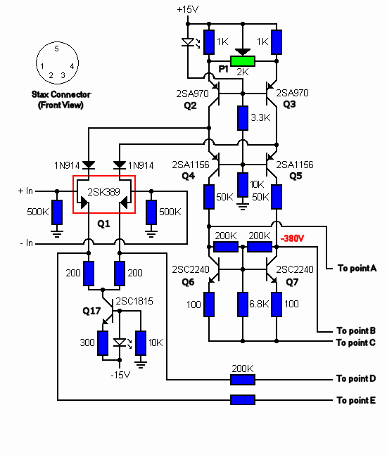

可对末级那众多的P型高压管的来源犯了愁。。。
另对于它的长期可靠性表示担忧。。。
单纯的做它问题不太大的。。。:D

P大。。。
您把007T的末级电路给俺搞到俺就可定稿了做哪种。。。:D

这部分俺在斟酌中。。。

Type Designator: 2SA1968 Material of transistor: Si Polarity: PNP Maximum collector power dissipation (Pc), W: 2 Maximum collector-base voltage |Ucb|, V: 900 Maximum collector-emitter voltage |Uce|, V: 900 Maximum emitter-base voltage |Ueb|, V: 7 Maximum collector current |Ic max|, A: 0.01 Maximum junction temperature (Tj), °C: 150 Transition frequency (ft), MHz: 6 Collector capacitance (Cc), pF: 2.2 Forward current transfer ratio (hFE), min: 20 。。。:D
