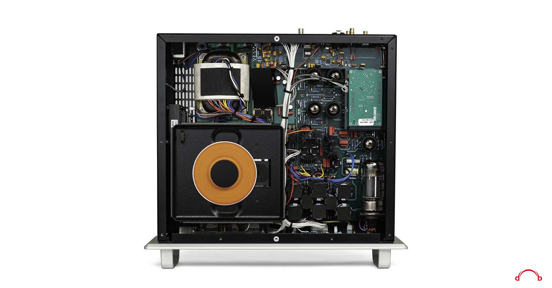

(CD9SE内部赏析)
这台CD9SE在之前的2020年度推荐器材发文中被选中就是因为厂家把该花的钱都花在了刀刃上,从整体到细节都很用心。CD机要出好声,关键在哪几方面?
*扎实的电源储备(使用两只变压器加滤波电容阵)
*稳定的转盘机构(采用几乎绝迹的飞利浦pro2转盘)
*重视模拟信号放大(采用4支6H30超级管做放大)
*强大的D/A转换性能(24Bit DAC双单声道线路架构:采用四路24bit数模转换芯片以单声道模式运行,配合双主时钟系统工作,一只处理44.1kHz/88.2kHz/176.4kHz取样率的数字信号,另一只处理48kHz/96kHz/192kHz取样率的数字信号,同时还进行时基校正,并提供升频功能。)
*与时俱进的数播解决方案(USB线连接笔记本轻松组建高素质数播系统)
此机适宜人群
手头CD收藏一大把,又想兼顾一下本地数字文件播放的烧友。小毛体验下来,既方便又有素质。同时,如果您想在系统里加入胆环节,让系统增添些模拟味的也相当适合。因为系统里加胆CD的排异风险比加胆前级低得多。

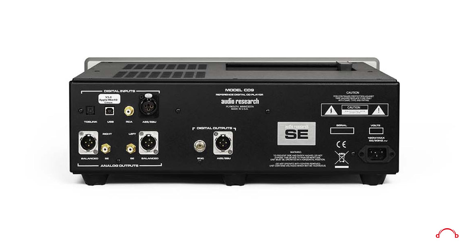

Description
Top-loading, remote-control, tubed CD player with optional upsampling, two digital reconstruction filters, and digital inputs/outputs.
Tube complement
four 6H30 dual triodes (analog stage), one 6H30 and one 6550C (power regulation).
Digital inputs
S/PDIF (TosLink, BNC, RCA), AES/EBU (XLR), and USB.
Bit depths handled
16 and 24 bits. Sample rates handled: 44.1, 88.2, 96, 176.4, and 192kHz.
Digital outputs
BNC, AES/EBU.
Analog outputs
single-ended (RCA), balanced (XLR).
Frequency responses
3Hz–96kHz, +0/–3dB; 20Hz–20kHz, ±0.15dB
Signal/noise
110dB. THD: <0.003% at 2V RMS, balanced output.
Output impedance
660 ohms balanced, 330 ohms single-ended.
Recommended minimum load
20k ohms with 2000pF maximum capacitance.
Channel separation
107dB at 1kHz.
Power consumption
120W maximum, 1W in sleep mode.
Dimensions
19" (480mm) W by 5.25" (134mm) H by 15.375" (390mm) D. Front handles add 1.5" (38mm) to depth.
Weight
33 lbs (15kg) net, 43 lbs (19.5kg) shipping.
