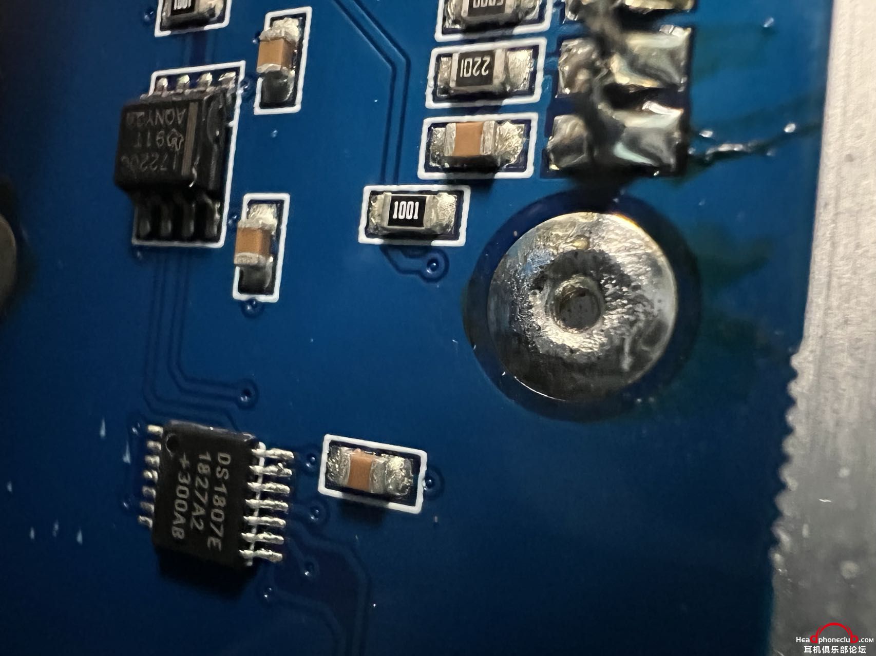

 楼主| 发表于 2022-10-3 23:06:01 | 显示全部楼层
amex 发表于 2022-10-2 14:34
草,用音量芯片控制ref电压还真是奇妙思路……有大图吗,看看他输入连的哪
手机里导出几张图,看看能否看清楚电路
音量旋钮背面pcb板
音量旋钮背面pcb板
DS1807音量控制芯片
DS1807音量控制芯片
排线连接到主板后
排线连接到主板后

发表于 2022-10-4 17:32:26 | 显示全部楼层
Especially in case of R2R ladder DACs it is quite easy to change the output voltage of the DAC by changing its reference voltage . The SDA-2, a new generation DAC module was designed to get the best regulation possible. The result of this process is an extremely high linearity, right down to -140 dB, which gives our products a realistic 24 bit dynamic range.
官网说法,看来确实是控制ref电压
那个看了下芯片定义,应该只用了一个音量通道。
