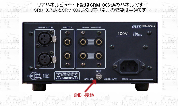

stax 006T放大器尾部有个接地端子,从来没使用过,查了下论坛也没人讨论过,所以发贴询问有没有必要用,该怎么用呢?知道的朋友指点下,谢谢啦!

我是搞电信的,顺便回答一下。。。
设备接地主要是防雷;耳放接地,估计是把一些金属外壳一些干扰都导入地下,以便设备更好地工作,提供不受影响的放大。
Graham Slee 对SOLO的GREEN和PSU1有个介绍,可以参考:
http://www.audiocontrol.co.uk/graham_slee/solomc.htm
Which power supply?
The lowest cost or entry option is the Solo SRG/Green supplied with its energy saving switched mode (SM-PS) plug-top power supply. SM-PS have more leakage than linear power supplies which means you may have to use a supplementary earth wire: because the Solo SRG case is metal some people can feel a slight vibration sensation when a hand is drawn across it - although this is approved as being safe it can cause annoyance to some. This slight case vibration can also subtly modulate the sound in some circumstances, so in a similar way to grounding a turntable, we provide the Solo SRG (now fitted on both options) with a rear-panel grounding post from which can be run an unobtrusive "earth" wire to another earthed system component, an earth spike, or the earth pin of a mains plug (CAUTION: Wiring to the wrong pin can cause electrocution! as well as considerable damage). Although the SM-PS saves over 80% of idling power making it a contributor to world energy conservation, the above experimentation will be required to get the best out of your Solo SRG/Green headphone amplifier. The alternative is to use our PSU1 powered option, which although being more expensive also offers a subtle improvement in information retrieval making it the more musical proposition in a high resolution system.

接地方法:
专业电信接地是采用铜排深埋入地下,设备再通过PGND连接到铜排;
一般来说,每个大楼都有一个接地系统。我们普通接地,可采用6mm2的接地线,从耳放的接地端子,连接到大楼的接地系统中。如果大楼或机房没有专门的接地铜排,变通的方法是连接到窗户或其它和大楼相连并有金属接触面的地方,固定即可。

前面的英文内容取自SOLO的官方网站,大意是普通绿色版SOLO,当你的手碰到外壳时,有时会有电流振动触感,虽然是安全的,但是有点烦。所以SOLO提供了接地端子,接地后就OK了。另一个解决方案就是购买PSU1线性电源,也就是SOLO豪华版。
