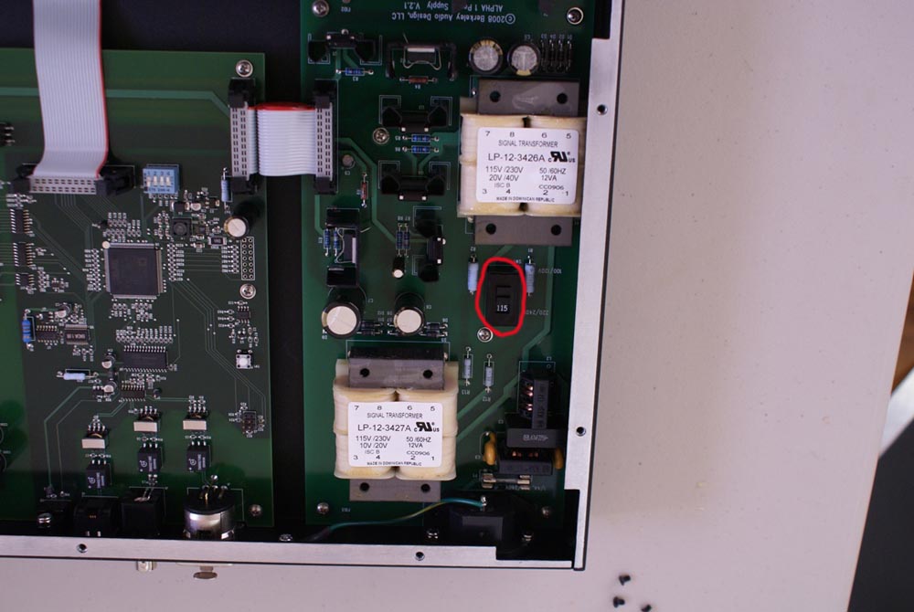

此机是不是只要按下图中按钮就可以把电路在115~230v之间调节???
是不是只需要按这一个按钮???
不太敢尝试来问下各位朋友~~~

正常就是了,最好发email问问原厂吧,或者看看说明书

拨过去,如果从原来显示115变为现实230的字样,则就对了。否则就不对。

Thank you for writing and for your purchase of an Alpha DAC.
To convert an Alpha DAC from 115V operation to 230V operation, two things must be done:
1. Move voltage switch SW1 on the power supply PCB from the 115V position to the 230V position.
2. Change mains fuse F1 on the power supply PCB from a 5 mm x 20 mm .5A Slow Blow (Littlefuse 0239.500HXP) to a 5 mm x 20 mm .25A Slow Blow (Littlefuse 0239.250HXP).
Someone with technical experience should perform the voltage change. If switch F1 is in the wrong position and/or fuse F1 is the wrong type or value for the local AC mains voltage, the Alpha DAC may be damaged and the warranty will be void.
I hope I have answered your question satisfactorily. Please let me know if you have any further questions

这不是回信说得蛮清楚了,1是拨动开关,2是换保险管。

上面写着是换0.25a的保险丝是吧

是的,0.25A的。
其实不用他们说明保险丝,想都能想到的。功率W=I*U,当W不变而只有电压变了,则当W=0.5*110,于是W=0.25*220;故保险应换为0.25的。(哈,不用解这个方程吧)

保险换不换都问题不大的.把开关整到230就可以了
