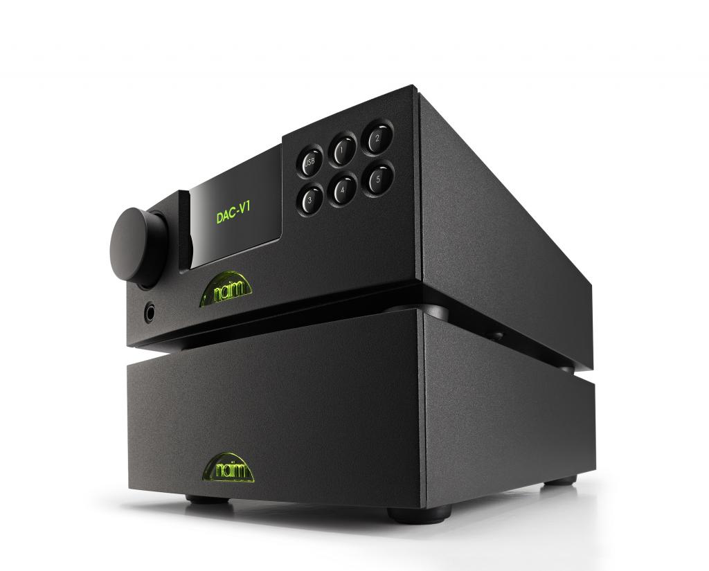

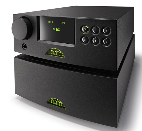

http://www.whathifi.com/news/ces ... 100-power-amplifier
It has an asynchronous USB input, able to handle audio at up to 24-bit/384kHz, while the five S/PDIF digital inputs (BNC, 2x optical, 2x electrical) can handle formats up to 24-bit/192kHz.
标价1250英镑,被英国论坛誉为Benchmark杀手...
异步解码 (号称内置操作系统,将电脑影响降到最低)
XS2级别的Naim经典前级线路
5路数字输入
Sharp 0 Jitter线路
A类耳放
OLED屏幕
更多功能将通过固件升级提供。
Key features:
  • High-speed asynchronous USB input up to 24bit/384kHz
  • 5 x S/PDIF inputs up to 24bit/192kHz (1 x BNC, 2 X RCA, 2 x TOSLINK)
  • Selectable fixed or variable analogue outputs (DIN or RCA)
  • Zero S/PDIF Jitter design in common with the original Naim DAC
  • Naim custom designed Digital Filtering with 16 times oversampling
  • SHARC ADSP21489 DSP for Digital Filtering and zero S/PDIF jitter
  • Classic discrete Naim preamplifier gain stage topology with selected components
  • High-quality Burr Brown PCM1791A DAC, in common with NDX and SuperUniti
  • Single ended Class-A headphone amplifier. Front panel ¼ inch headphone output
  • Optical isolation between digital and analogue sections
  • Naim digitally controlled analogue volume control for performance and precision
  • Linear power supply with 210VA transformer, windings for Digital, DAC and analogue stages
  • Operates with computers running OSX, 10.7 and above, Windows XP, 7 and 8
  • Floating or Chassis ground switch for optimum performance with any system
  • Field upgradeable firmware
  • OLED display for adjusting settings and checking incoming bit-rates
  • Control via IR remote control or front panel controls
  • DAC-V1 can control computer playback and volume
  • Compact non-magnetic low-resonance chassis and sleeve
  • British design and build
配套的迷你后级采用双单声道设计,售价650英镑(约6500元)
