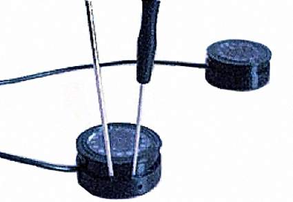

Method 1 (Skippy): Pour boiling water onto a cookie sheet (about 1/8-1/4" deep) and put the Grado earcups grill-side down into it. Keep them there for about a minute, and then remove them. The glue softens and the earcup sections should slide apart.
Method 2 (Skippy): Insert a small screwdriver (a jeweler&#39s screwdriver will do) into the crack between the 2 halves of the earcup and carefully pry. Insert a second small screwdriver a bit to the right of the first one. Carefully pry. Take the first screwdriver and insert it a bit to the right of the second one. Pry carefully. Repeat this process, going around the cup until the seal loosens. Finally pull the cup apart.
Method 3: (Beagle): "Blow dry" the plastic enclosures with a hair dryer for about 1 or 2 minutes. Point the hairdryer at the sides of the enclosure, not directly at the front or back. If you fire from 3 or 4 inches away and take a little more time, you get the same results with no risk of affecting the plastic diaphragm. This softens the glue, and you can they pry or twist the enclosure apart.

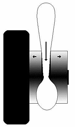

Method 4 (Mole): Thanks to the collected Grado mods page I got the courage to take apart my Grado SR125s. It was nerve wracking to say the least, because none of the suggestions on how to take Grados apart seemed to work. First I tried prying with a small screwdriver, but I didn&#39t have the heart to do that much damage to the housing. Then I tried lowering the grilles in hot water. No effect. Still couldn&#39t twist the cover off.
Finally I came up with another idea: I found a teaspoon with a sort of tapered handle that I used as a wedge to gradually ease the two parts of the cans apart. You keep the handle of the spoon pressed flat into the crack between the two halves of the Grados using your thumb, and then you pull on the "bowl" of the spoon so that the wider part of the handle forces the two halves apart. You start of where the handle is narrow enough to fit and then force the halves apart. It&#39s all a matter of finding a teaspoon with the right shape.
One of the reasons I think the other methods didn&#39t work was that the SR125 has some kind of rubbery superglue applied where the edge of the transducer half meets the grille. From what I understand other Grados (SR80, SR60 etc) have superglue applied BETWEEN the two halves of the housing, so by prying them apart the glue will "snap". I also doubt the rubbery stuff (somewhat like Liquisole used for repairing shoes) is affected by moderate heat in any substantial way.
Instead of resealing with a glue gun, I placed a strip of black electrician&#39s tape along the inside of the grille part to make the fit nice and snug. That should make it easier to take the cans apart again if the need should arise. (I&#39m planning on applying the "mini-phono jack" mod in the future.)

除了挖洞之外,那个消除声音"皱纹"的改装方法是?尤其是图三,我配着文章也没看明白,怎么搞成那样的?全部破坏么?

HEADFAN兄,除了开洞外,其他两种改装方法麻烦讲解下,谢谢哦~

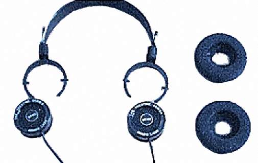

我自己DIY的海绵套
