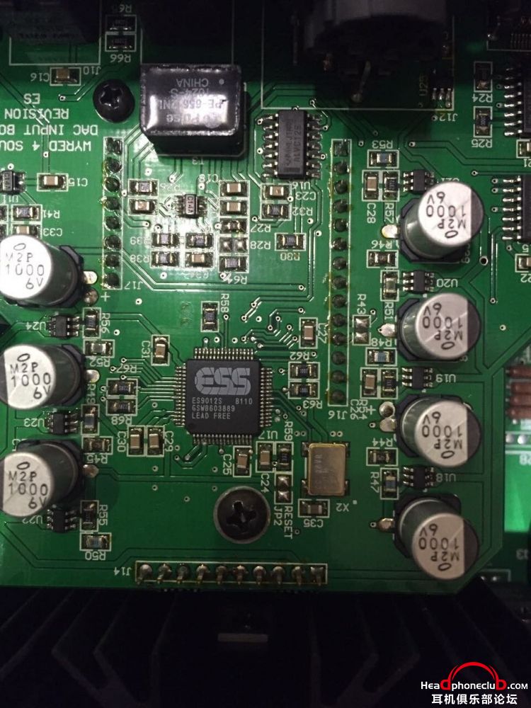

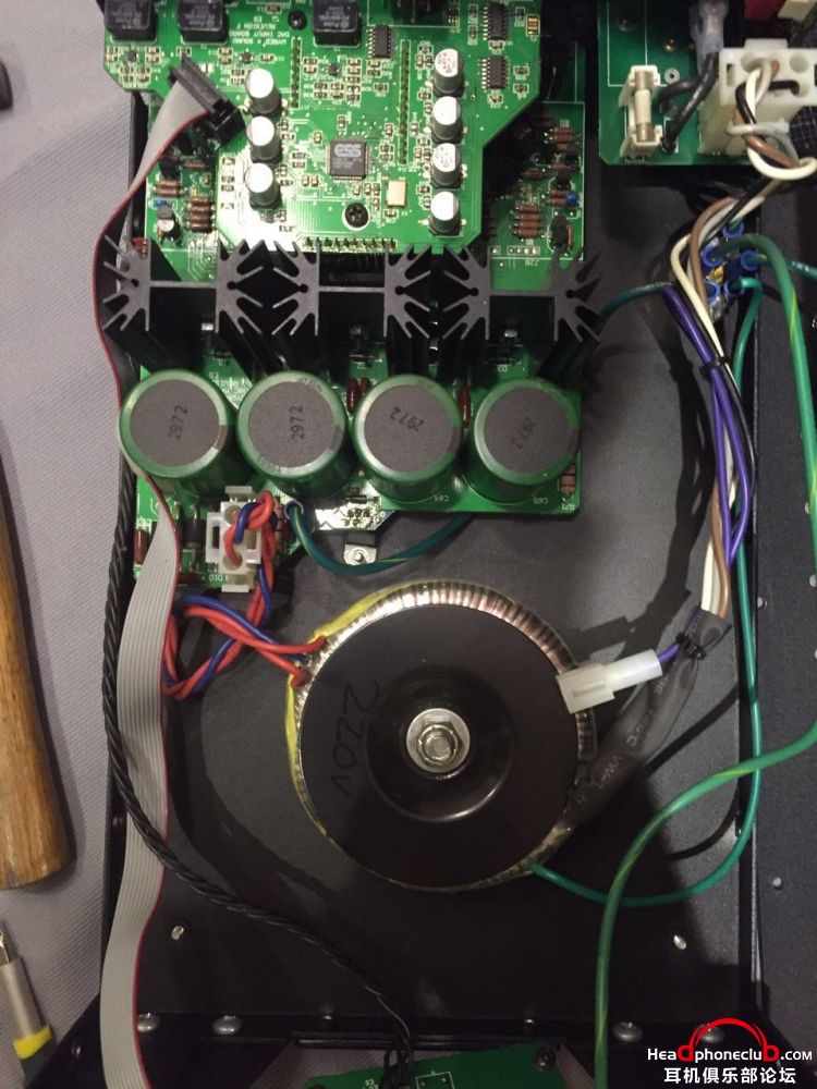

http://www.datasheetspdf.com/datasheet/download.php?id=903101
看起来,9012是官方做好的9018双通道并联(4+4并2)版,参数和mono(8并1)只差2db
pdf都是共用一个

惊动版主了,这个是早期产品,我二手收的。厂家回复如下:
That chip is the equivalent of a 9018, just 2 channel instead of 8. There was a brief time when ESS did not have 9018s available, instead they supplied us 9012s and assured us that sonically they were the same as the 9018. You can check with ESS on this if you’d like.
