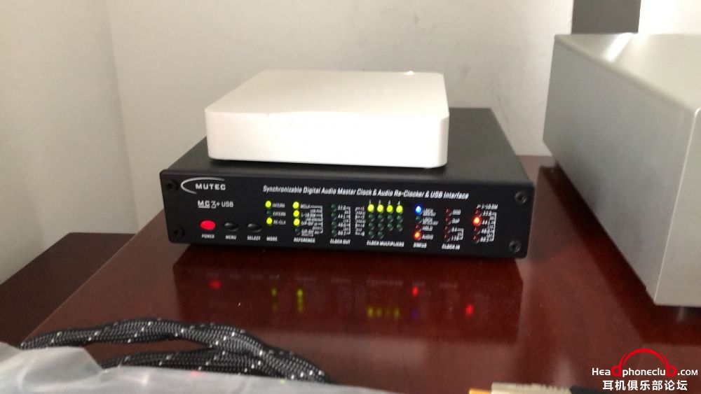

听说这个,还是源自一位资深烧友的分享,在long long ago 他买了两台,用在家里和办公室的音响系统内,感觉效果很好。这里未征得他的同意盗图一张。
他的前端是声韵小白羊,非常超值的小东西,MC-3+链接数播和解码。
听他介绍后,上网看了看,很不错的产品。

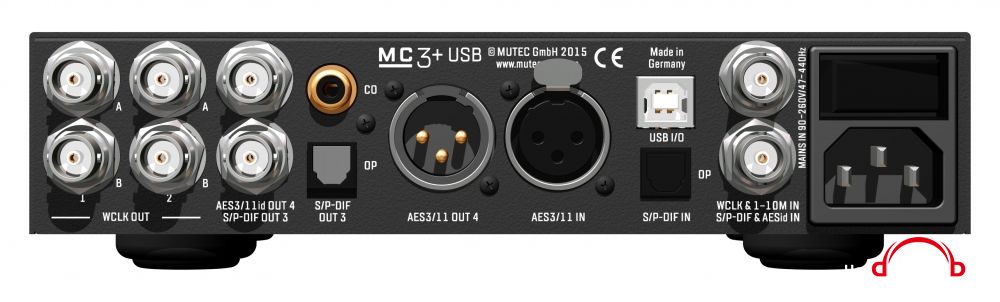

德国制造,背部的接口很丰富,AES,同轴,外部时钟,关键的还有USB
接口有:
  • 1 x USB2.0 interface, bi-directional usable
  • 1 x BNC input for Word Clock + 1-10MHz, 75 ohms termination switchable, unbalanced
  • 1 x XLR input for AES3/11, 110 ohms terminated, transformer balanced
  • 1 x BNC input for S/P-DIF + AES3id, 75 ohms terminated, unbalanced
  • 1 x Optical input for S/P-DIF, Toshiba ToslinkTM, EIAJ RC-5720
  • 4 x BNC outputs for Word Clock, terminated, unbalanced, individually buffered, adjustable in pairs
  • 1 x XLR output for AES3/11, terminated, transformer balanced, buffered
  • 1 x BNC output for AES3id, 75 ohms terminated, unbalanced
  • 1 x BNC output for S/P-DIF, 75 ohms terminated, unbalanced
  • 1 x Cinch (coaxial) output for S/P-DIF, terminated, unbalanced, buffered
  • 1 x Optical output for S/P-DIF, Toshiba ToslinkTM, EIAJ RC-5720

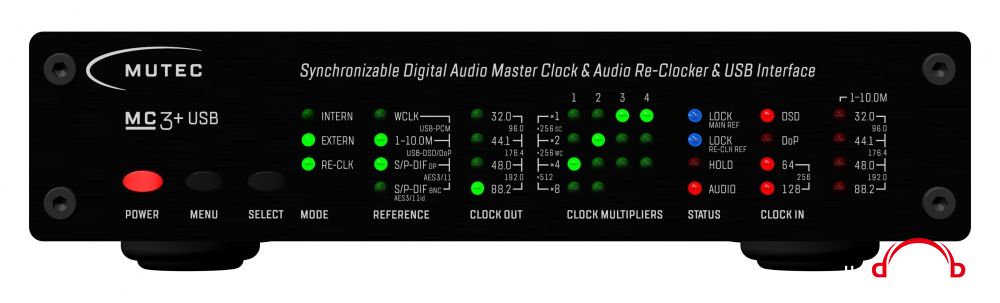

原厂的产品介绍
The MC-3+ Smart Clock USB is setting a new benchmark for clocking technology and the reproduction of digital audio by uniquely combining an audiophile USB interface with an audio re-clocker in perfection! Particularly designed for the demands of high-end consumer audio, the device expands a new sonic universe with increased musicality, clarity, and precision. As such, the MC-3+USB will prove its worth in many audiophile listening rooms around the world.
机器翻译盗一下(下面都是
mc- 3 +智能时钟USB正在为c锁定技术和数字音频的复制设置一个新的基准,通过独特的组合一个音频的USB接口和一个音频的再clocker完美!特别为高端消费者音频的需求设计,该设备扩展了一个新的音域,增加了音乐、清晰度和精度。因此,mc -3+ USB将在世界各地的许多音响爱好者中证明它的价值。
Unique, bit-transparent Re-Clocking without conventional sample rate conversion for purest sound quality
独特的,透明的重新锁紧,没有常规的采样率转换为最纯粹的声音质量
Audiophile, asynchronous two-channel USB interface with ultra-low noise audio clock oscillators and total galvanic isolation of up to 2500 VRMS, respectively 4242 VPK, for suppression of high-frequency interferences
具有超低噪声音频时钟振荡器的异步双通道USB接口和高达2500 VRMS的全电隔离,分别为4242 VPK,用于抑制高频干扰
Converts DSD/DoP streams (64-256) to PCM audio with selectable output clock rate
将DSD / DoP流(64 - 256)转换为PCM音频,可选择输出时钟频率
Locks to MUTEC's REF10, as well as so-called atomic clocks and GPS clock references
锁到MUTEC的REF10,以及所谓的原子钟和GPS时钟引用
Improved, next-generation REVIVE re-clocking and 1G-Clock technology by MUTEC
改进了,新一代恢复了重新锁定和1g时钟技术的MUTEC
  • Serves as a flexible digital input switching matrix, audio format converter and master clock
  • Compatible to Apple Macintosh and Windows PCs
  • Intuitive user interface and easy installation
  • Update-capability via USB
  • Available with black- or clear aluminum front panel
  • Galvanic isolation up to 2500 VRMS in accordance with UL1577, respectively 4242 VPK in accordance with DIN EN 60747-5-2 (VDE 0884 part 2)
  • Converts DSD/DoP streams (64-256) to PCM audio with selectable output clock rate
  • Transfers USB audio streams into AES3 and S/P-DIF and outputs those to five digital audio formats simultaneously
  • Converts between USB PCM audio, USB DSD/DoP audio, AES3 and S/P-DIF, as well as between AES11 and Word Clock
  • Highly compatible USB audio class 2.0 driver for Windows supporting ASIO, MME, DirectSound, WASAPI, Kernel Streaming, PCM 16Bit, 24Bit, 32Bit and Float-32Bit at all clock rates between 44.1kHzand 192.0kHz
  • Ultra-low jitter Word Clock generation with clock rates up to 1,536.0 kHz
  • Scalable to FS1x512 clock rates, 22,5792 MHz & 24,576 MHz, for e.g. high-end audio interfaces
  • Locks to Rubidium- (10 MHz), Cesium- (5 MHz) and GPS clock references
  • Generates Word Clocks, Super Clocks, AES3 + S/P-DIF blanks simultaneously
  • Uninterruptable, fail-safe clock generation in all operation modes
  • Eliminates so-called digital "clicks and pops"
  • Individual lock indicators for the clock or audio reference and the re-clock reference
  • USB, AES/EBU, AES/EBUid and S/P-DIF interfaces in one box
  • S/P-DIF interconnections via BNC, RCA and optical interfaces available as in- and outputs
  • Front panel lock-out for preventing of misuse
  • Rack-space-saving 9.5" housing
  • Built-in, universal power supply

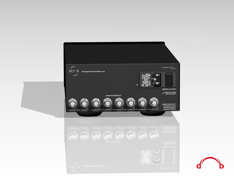

而其可以配同款的10M外置时钟
貌似只有黑色的
参数说明:
MUTEC REF 10是一个拥有10兆赫兹信号的发烧友参考主时钟,它具有行业领先的低相位噪声(即抖动),以显著改善数字回放系统。作为你家里数字音频管弦乐队的指挥,REF 10将以前所未闻的清晰、优美的动态和纯音乐来激励你。它是市场上最灵活、最兼容的10 MHz时钟,可以让你少花点时间去担心整合,让你有更多时间享受快乐的回放。
解锁一个更动态、更透明的声音舞台,具有非凡的空间性和细节水平,没有任何数字模糊。对于所有的音乐爱好者来说,要达到信号纯度、音质和时钟精度的顶峰,REF 10是你的数字回放链的必备品。
  • Audiophile 10 MHz reference generator with industry’s lowest phase noise
  • Improves and enhances compatible DACs, audio re-clockers, music servers, and master clocks
  • Engineered around a handcrafted, ultra-low phase noise OCXO made in Germany
  • Generates a very high slew-rate square wave signal for superior lock precision compared to the sine wave signals used by competing brands
  • Provides simultaneous reference outputs with 50 and 75 Ω impedance for maximum compatibility with clocks and DACs by other manufacturers
  • Eight galvanically isolated, individually switchable BNC clock outputs
  • Revolutionary, sub-Hz optimized, lowest noise power supply for every circuit section
  • Integrated, highest-quality international linear power supply
  • Highly efficient power line filtering
  • Intuitive user interface with noble aesthetics
  • Rack-mountable with optional mounting brackets for studio use (2 RU)
  • 3-year extended manufacturer-guaranteed warranty
  • 这个时钟50欧75欧输出都有,应该适应性不错
  • 目前可用的数字转换器、主时钟和音频再clockers在复制或处理数字音频时表现得很好。即便如此,我们在MUTEC认为,现有的解决方案无法实现音频产品的全部潜力。在我们致力于推进艺术和科学的现状的承诺中,我们开始研究进一步提高数字音频系统性能的可能性。为此,我们招募了德国最著名的射频工程师之一加入我们的研发团队。我们一起开发了一个主时钟发生器,它的技术性能超出了我们的想象。技术性能的影响随后被一组经验测试的测试人员验证,以确保高端的性能转换为一流的声音。
    我们的广泛努力的最终结果是REF 10:一个高级的10 MHz参考主时钟和我们的第一个Empyreal类产品,它将不妥协的工程与简单性和最高时钟精度结合在一起。
  • 我们的研究表明,基于铷或铯振荡器的所谓“原子钟”的高时钟稳定性仅限于长期的时域。这种长期稳定指的是绝对时钟频率(在这种情况下每秒10兆赫,或1000万周期)随时间漂移。虽然这种长期的稳定性可能对某些电信应用程序有用,但实际上与数字音频的目的无关。最终,当数字音频流从一个设备传输到另一个设备时,从一个样本到另一个样本的时间,需要尽可能精确地达到最好的声音质量。短期稳定性的波动被测量为抖动或相位噪声,是任何数字音频设备的音频设备的核心。
    与这些“原子钟”不同的是,REF 10是围绕着在德国制造的MUTEC的手工制造的oven-可控振荡器(OCXO)而设计的,它的时钟稳定性最高,与音频的数字音频性能有关。
