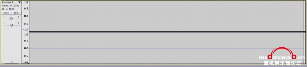

发表于 2017-12-15 08:17:16 | 显示全部楼层
这是LZ两个文件反向叠加后的波形。全部为0。文件播放听不到声音。
文件MD5不一样是因为文件里头有些元数据,大概就是曲目名称,版权之类的信息可能不同。数据可能是一样的。
数据相同,但是波形渲染是个实时计算,显示出来可能是有差别的。播放的时候,不同时间点的DA过程,声音也是有差别的。别说不同的两个文件,就是同一个文件,两次播放声音都不一样。
在光驱反复读取的情况下抓鬼,数据全对(无损)的可能性是非常大的。即使有损,也就只是一点的时间上的声音不对,不会有大面积的问题。

发表于 2017-12-15 08:37:37 | 显示全部楼层
下面是audio diff Maker 的输出
>> (not configured for EQ response correction)
>> ---Beginning difference extraction---
>> Files are stereophonic, at 44.1kHz sample rate, about 179 seconds long.
>> The Reference track is 16 bits; the Compared Track is 16 bits
>> Using Large memory algorithms
>> Finding the spectra of the "Reference" and "Compared" tracks
>>    [quad fourier transform: size 4x 16777216]
>> Correlating the "Compared" with the "Reference"
>>    [inverse fourier transform: size 16777216]
>> Coarse Time Offset = 0sec.
>> Move track subsections to freqency domain
>> Transforming overlapped portions of "Reference" and "Compared" tracks
>>    [quad fourier transform: size 4x 131072]
>>    [fourier transform: size 131072]
>> Calculating energy in Reference track
>> Beginning fine determination of time offset between tracks
>> Finished fine determination of time offset between tracks
>> Beginning fine determination of gain difference between tracks
>> Finished fine determination of gain difference between tracks
>> Aligning the "Compared" track to the "Reference" track
>> Sample Rate error is 0 ppm, adjustment unnecessary
>>    [dual inverse fourier transform: size 2x 16777216]
>> Saving the aligned COMPARE file and calculating the Difference track
>> Calculating Correlated null depth.
>>    [fourier transform: size 8388608]
>> Complete: saving the "Difference" WAV file
>> Parameters: 0sec, 0.000dB (L),  0.000dB (R)..Corr Depth: 300.0 dB (L), 300.0 dB (R)
分毫不差的音频数据。

 楼主| 发表于 2017-12-15 10:54:21 | 显示全部楼层
文件MD5不一样是因为文件里头有些 ...
谢谢解惑。
波形渲染原来是个实时计算,我一直以为是固定值,还是基础知识不够闹了个笑话啊。
文件MD5不相同是因为第二次抓轨把曲目信息存了进去,导致多了几个字节,这点没问题,层主好专业。

发表于 2017-12-15 11:18:44 | 显示全部楼层
冰冰啊 发表于 2017-12-15 10:54
谢谢解惑。
你的实验非常好。可以证明两次抓轨是一样的,所以有很大机会是无损。
回放过程是非常复杂的。所以存在各种可变因素。
举个不恰当例子,就好比让你打一分钟拍子,那肯定是不可能完全准确的。假如连续打两次一分钟拍子,这两次肯定是不同的。
另外,在平地打拍子和在行驶的公交车上准确度肯定也是不同的。
所以,即使抓轨数据完全一样。但是CD和文件回放的过程还是有非常多不确定因素。

发表于 2018-8-13 13:21:11 | 显示全部楼层
你犯了一个巨大错误,就是反向叠加的时间精度,你显示器看是没有区别,但是你要是放大 10倍 100倍后就会发现有细微的区别了,两个时基很难对的上,我曾今试过,gold wave打开两个同一首歌的不同源,耳朵听是能发现区别的,但是图形如果粗看是一模一样的,然后我放大100倍后,发现同样时刻,波形Y轴电平值是有细微差别的。不是没有差别,而且你横轴放大的粒度不够大,如果精确度提升10-100倍,你就能看到区别了。
