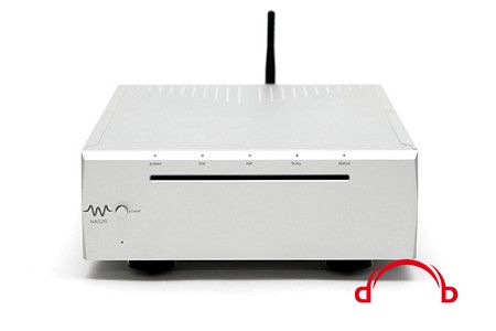

WNSA2R WNAS2  usb数码播放器  网络nas。
TB2fHaqnnnI8KJjy0FfXXcdoVXa_!!182550488.jpg TB2hLFwncjI8KJjSsppXXXbyVXa_!!182550488.jpg

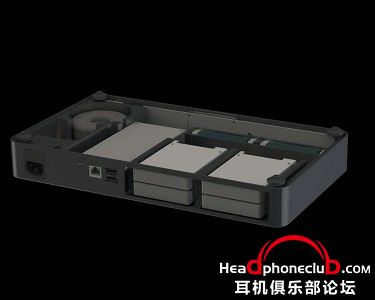

WNAS2R内部照片
WNAS2C即将上市

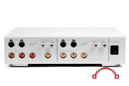

WAMP2.5 Full Digitial Integrated Amplifier
Key Features
Monaural construction integrated amplifier
Digital PWM based class D amplifier with PBTL 600W per channel
FPGA based Waversa Audio Proessor(WAP) type 2 applied with built-in 768KHz high-end upsampler
2x Full balanced inputs and 3x unbalanced inputs
Digital Coaxial input for CDT/CDP(44.1K only)
Waversa's custom ground noise reduction(Ambient Control) technology applied
Ambient Control Options (None, 25%, 50%, 75%, Max)
Waversa Ultra Sound Support (Level 1, 2, 3)
8 level LED brightness control
180~240 VAC @ 50Hz/60Hz
W 440 x L 330 x H 145 mm
13Kg

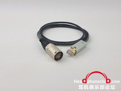

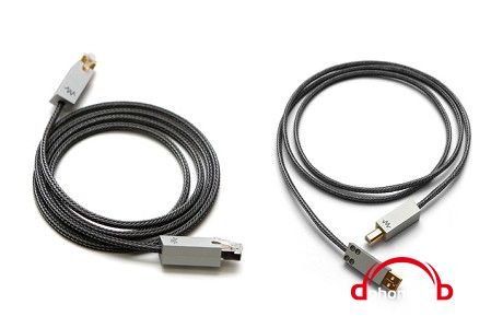

WAVERSA  LAN 线
180518_WLAN_WDAC1.jpg 180518_WLAN_WDAC2.jpg WLAN_2.jpg 20150506113852_vmwdkwrl.jpg
