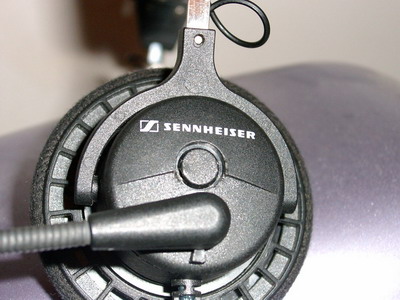

  自己改了线,用来聊天,各位老大对它有了解吗?
HME 45 - CA
Technical data
Weight, without cable 140 g
Length of cable 1.8 m
Connector HME 45-CA XLR, 5-pin
Connector HME 45-KA PJ-055, 6.35 mm ø (headphone)
PJ-068, 5.25 mm ø (microphone)
Headphones
Transducer principle dynamic, open
Frequency response 20 to 18,000 Hz
Impedance 1200 Ω per system
(connected in parallel)
Sensitivity (1 kHz, 1 mW) 102 dB ± 3 dB
Total harmonic distortion < 1 %
Contact pressure approx. 1.6 N
Microphone with amplifier
Transducer principle back electret condenser microphone
Frequency response at a
distance of approx. 2 cm from
the corner of the mouth 300 to 5,000 Hz
Max. sound pressure level 120 dB
Output voltage 400 mV ± 3 dB at 114 dB SPL
(as per RTCA / DO-214)
Min. terminating impedance 150 Ω
Supply voltage for microphone 8 - 16 V DC, 8 - 25 mA

各位老大都只看不说,忍不住我自己说了,是空客A319飞机上飞行员佩戴的耳机(价值$400左右),左右单元并联(通话不需立体声),原装线材断了一股,插头也是专用5芯插头。换线并改成立体声,听音乐很普通(可能声卡不大推得动),聊天还不错(话筒灵敏度可调节),只是可惜了原装线(真是好线啊……)
