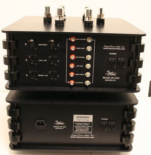

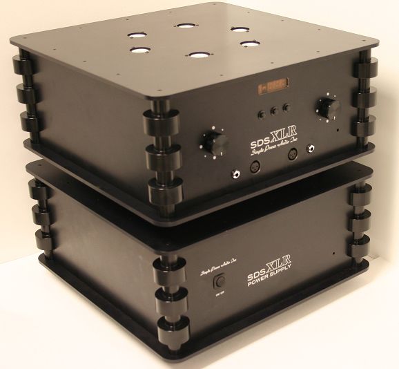

恩  SINLEPOWER  SDS-XLR 貌似这个论坛也有玩家在玩.....人在加拿大的  雨辰吧......不过购买经历非常曲折.....代价也很高昂.....他的貌似花了18000-20000美元 而且老头拖了他整整一年........而且MIKHAIL现在貌似由于信誉太差  跑路 不做了吧呵呵   不过那个使用者的评价 是相当的高..........图片也是相当的毒
437
2007-12-19
发表于 2009-5-24 11:41:18 | 显示全部楼层
http://www.erji.net/read.php?tid ... 5%D5%DF%B9%E9%C0%B4
当年的首发图片...此位仁兄也早以死在AF2000的刀下,,,,,,,,,,,,,

SINGLEPWER SDS
SE 的顶级旗舰! 停产了,连个2手的找不到!

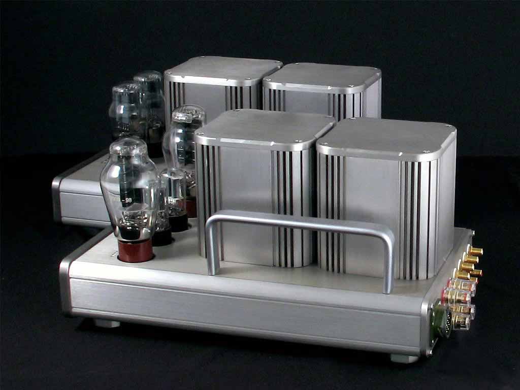

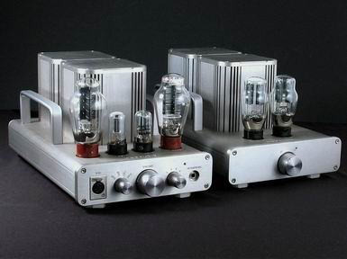

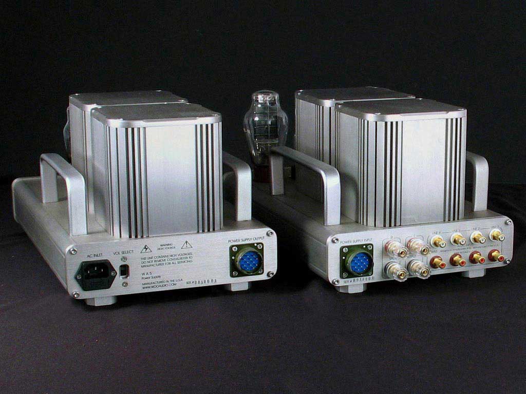

WOO AUDIO 5
管子好强大哦!普通版本也要3150刀啊!
* AMP and PSU ship in a molded foam within a wooden crate
        * Power supply umbilical cord is included.
                * 1 pair of 300B, 6SN7, and 2 tube rectifiers are included.
                        * AC Power cord and RCA interconnect cables are not included.
                * Shopping cart applies to the U.S. buyers only. International buyers please contact for shipping cost and payment instruction.
    Technical Specifications:
  • Two 300B [PDF] power tubes
  • Two 6SN7 [PDF] drive tubes
  • Two 5U4G [PDF] rectifier tubes
  • Voltage: AC 110/220V, 50/60 Hz
  • External dimension (each): 8½(H), 9"(W), 17"(D)
  • Weight: Amp Unit: 35 lbs, Power Supply Unit: 40 lbs
    Headphone Amplifier Specifications:
  • Headphones impedance : 8-800 Ohms
  • Frequency response: 10 Hz—60 KHz, -2dB
  • Power output >= 1.5 watt
  • Signal/Noise: >= 95 dB
  • THD: <= 0.08%, 1Khz
    Speaker Amplifier Specifications:
  • Power output: <= 10W x 2, THD <= 3%, 1Khz
  • Frequency response: 16—38 Khz, -2dB
  • Output impedance: 8 ohms
  • Signal/Noise: >= 90 dB
    Standard Features:
  • Independent headphone and speaker circuits
  • High-end output transformer design
  • Point-to-Point wiring
  • Selectable speaker, AKG-K1000, high and low impedance dynamic headphones output switch
  • One 1/4" headphone jack and one XLR connector for K1000
  • Four pairs of gold-plate RCA inputs
  • Selectable inputs switch
  • Two pairs of gold-plate speaker terminals
