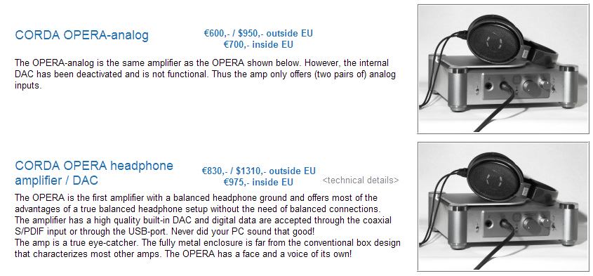

德国 CORDA OPERA - Analog
2 headphone outputs
( 0/120 Ohm output impedance ).
Maximum output 13V / 500 mA.
Gain switch. Maximum gain factors -5 / +8 dB.
Crossfeed filter switch:
1. Stereo / crossfeed OFF
2. Crossfeed ON
2 pairs of analog inputs
Input impedance 12 kOhm
1 digital S/PDIF input
1 digital USB-input
1 pair of volume-controlled preamplifier outputs.
Gold-plated input jacks.
Silver plated headphone jacks (Neutrik).
Silver plated heavy duty switches
Alps Blue potentiometer for volume control.
25 Watts toroidal transformer for the analog section.
7 Watts toroidal transformer for the digital section.
110V and 220V mains power switchable.
Power uptake 12 Watts
Built-in groundloop breaker.
Schottky rectifying diodes in the power supply.
Double regulated voltage lines.
Low impedance electrolytic buffer capacitors (Nichicon).
Total Buffer capacity 80.000 uF.
Bypass capacitors in the power supply.
Polystyrol and polypropylen capacitors in the signal path.
Metalfilm resistors in the signal path.
Double sided PCB
LM6171 opamps biased into class-A using LM334 current sources.
2 BUF634 buffer amplifiers at left and right headphone output channel.
(Active) balanced headphone ground
3 BUF634 buffer amplifiers at the balanced ground headphone output channel.
PCM2704 as USB-to-S/PDIF receiver
CS8420 as S/PDIF receiver (in high-jitter-reduction mode)
PCM1794 D/A converter-chip.
LM6171 opamps biased into class-A for I-V conversion.
Sampling frequencies / resolution
8..96 kHz / 16, 20, 24 bit (S/PDIF)
32, 44.1, 48 kHz / 16 bit (USB)
Star-grounding.
Ultra short signal paths.
Signal paths and signal path components at the bottom side of the PCB for maximal shielding.
Sturdy aluminium enclosure
Weight: 3.9 kg.
Size: 27.6 x 27.8 x 8,7 cm.

CORDA这个耳机放大器是德国人JAN MEIER的产品,不是美国的.

 楼主| 发表于 2007-5-1 13:45:05 | 显示全部楼层
原帖由 小白 于 2007-5-1 13:37 发表
AUDIO VALVE这个耳放我是第一次听说.
谢谢更正,已改。

德国 CORDA OPERA 的解码部分不知道如何
