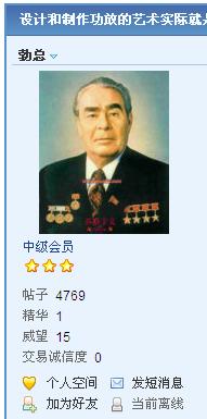

发贴人是家电HI-FI论坛著名的“勃总”。勃总整天忙着吵架,难得思路比较清晰、有条理地写点东西,转来看一看。

comrade Brezhnev would be pleased:D
